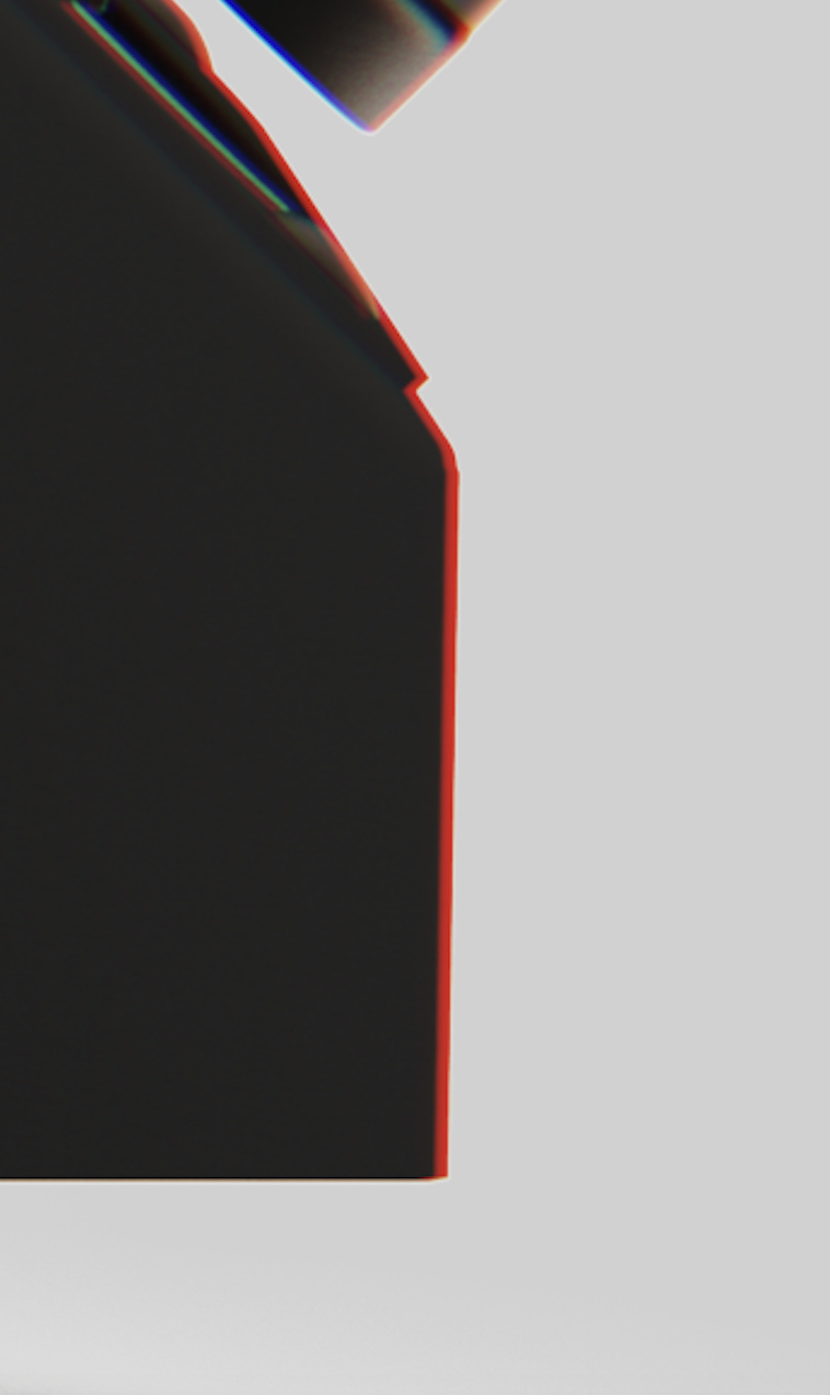

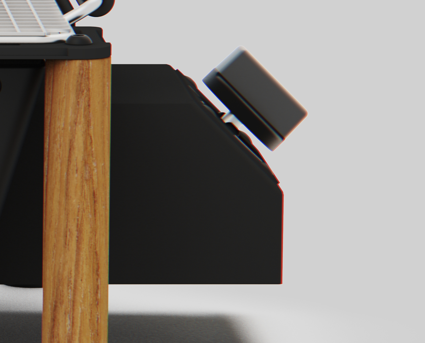

I am working on a some renderings both wth transparency and white background. The issue I am having is with a rather annoying blue or red hue around the edges of the objects.
I have tried adjusting as many settings as I can but the issue still seems to be occurring
Is there a setting I am missing or any solutions would be greatly appreciated.
check your image tab to see if Chromatic abberation is turned on. that’s looks very much like that.
Thanks very much! I’ll take a look and see if this changes the outcome
I get this when I turn on Rounded Edges to soften sharp edges. All of a sudden, strange halos and colors start showing up.
